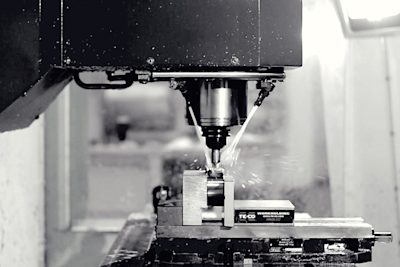

CNC milling
  • The workpiece is held stationary directly on the machine bed or in a vice.
  • Material is removed from the workpiece using cutting tools or drills that rotate at high speed.
  • The tools are attached to a spindle, which can move along three linear axis.
3-axis CNC milling machine in action
3-axis CNC milling machines are very common, as they can be used to produce most common geometries. They are relatively easy to program and operate, so start-up machining costs are relatively low.
Tool access can be a design restriction in CNC milling. As there are only three axes to work with, certain areas might be impossible to reach. This is not a big issue if the workpiece needs to be rotated just once, but if multiple rotations are needed the labor and machining costs increase fast.

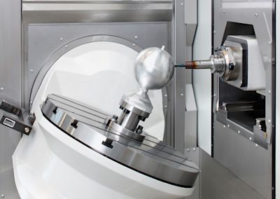

Continuous 5-axis CNC milling
  • The cutting tool can move along three linear and two rotational axes relative to the workpiece.
  • All five axes can move at the same during all machining operations.
Continuous 5-axis CNC milling center in action
Continuous 5-axis CNC milling systems have a similar machine architecture to indexed 5-axis CNC milling machines. They allow, however, for the movement of all five axes at the same time during all machining operations.
This way, it is possible to produce parts with complex, ‘organic’ geometries that cannot be manufactured at the achieved level of accuracy with any other technology. These advanced capabilities come of course at a high cost, as both expensive machinery and highly-trained machinists are needed.

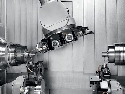

Mill-turning CNC centers
  • The workpiece is attached to a spindle that can either rotate at high speed (like a lathe) or position it at a precise angle (like a 5-axis CNC mill).
  • Lathe and milling cutting tools are used to remove material from the workpiece, forming the part.
5 axis CNC mill turning
Mill-turning CNC centers are essentially CNC lathe machines equipped with CNC milling tools. A variation of the mill-turning centers are swiss-style lathes, which have typically higher precession.
Mill-turning systems take advantage of both the high productivity of CNC turning and the geometric flexibility of CNC milling. They are ideal for manufacturing parts with ’loose’ rotational symmetry (think camshafts and centrifugal impellers) at a much lower cost than other 5-axis CNC machining systems.
