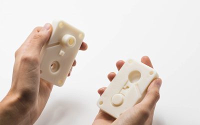

Material Jetting produces parts of the highest dimensional accuracy with very smooth surface finish, used for both visual prototypes and tooling manufacturing.
Benefits and Limitations
Multi-material capabillities
No support marks visible on surface
Smooth, injection molding-like finish
Higher cost than SLA/DLP
Brittle, not recomemended for functional parts
Price $$$$$ Tolerance ± 0.1% (min: ± 0.05 mm)
Turnaround time < 5 days Wall thickness 1.0 mm
Max part size 100 x 80 x 50 cm Layer height 16 - 32 μm

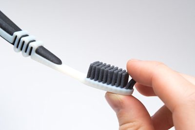

Rubber-like resin
Rubber-like resin (Material Jetting) produces high-detail parts with a soft rubber-like appearance and shore hardness < 70A. Not suitable for functional prototypes.
