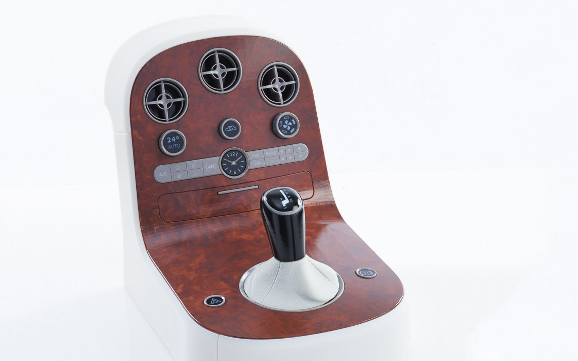

High detail visual prototypes
Unlike traditional prototyping methods some AM processes are able to produce multicolor designs with a surface finish comparable to injection molding. These models allow designers to get a greater understanding of the form and fit of a part. This highly accurate method of prototyping is also ideal for aerodynamic testing and analysis as the surface finish that is able to achieved is often representative of a final part. AM is used regularly to manufacture automotive components that rely on aesthetics over function resulting in everything from wing mirrors and light housings to steering wheels and full interior dashboard designs being produced. Material jetting and SLA printing are the two most common methods used for aesthetic prototypes producing parts from a photo-activated resin.
Full colour, textured visual prototypes like this centre console can be produced via AM (image courtesy of Stratasys)

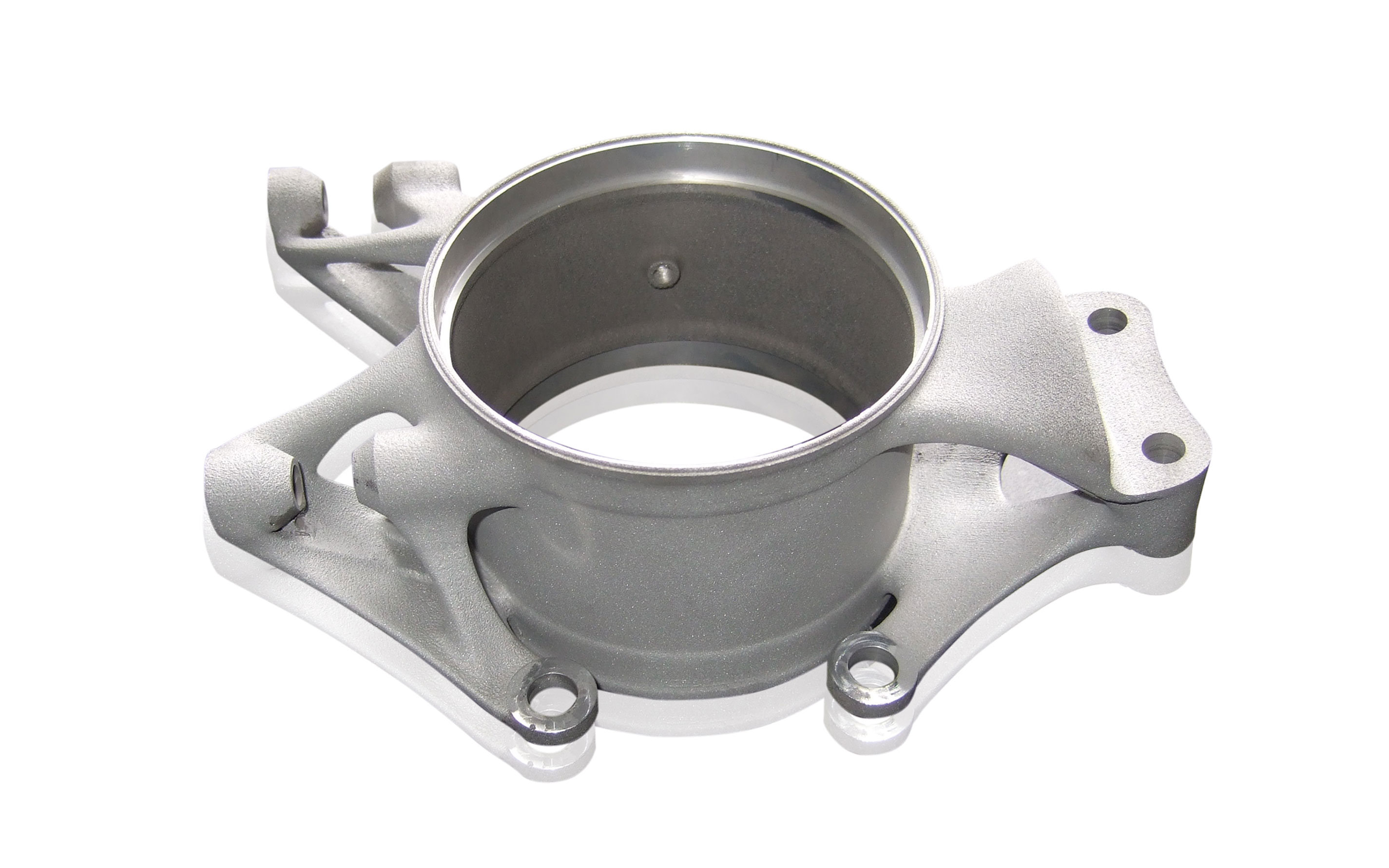

Case study 1 - Formula Student Germany
Formula Student is an international student design competition that was initiated in the USA in 1981 by the Society of Automotive Engineers (SAE), and has been held in Europe since 1998. The fiercely competitive international competitions take place on race tracks in Europe, the USA and Asia, and each team decides individually in which competitions it would like to take part.
As part of the optimisation of their car, Formula Student Germany set out to design and build a reliable, lightweight axle-pivot (knuckle) with high rigidity, in the shortest possible time. The knuckle needed withstand the dynamic loads that racing cars are subjected to while also reducing the overall weight of the car. The resulting design was a topographically complex single component only capable of being manufactured using AM technologies. For this application DLMS was the best fit as it enabled to manufacture of a functional metal part with complicated geometry.
By optimizing the geometry of the knuckle the final design was 35% lighter than the original design and improved rigidity by 20%. The use of AM technology also resulted in a significant reduction in development and production time and better reliability on the track (which in turn improved safety).
Compared with previous aluminium wheel carriers the team was able to save a total of 1.5 kg in vehicle weight, achieveing the lightest vehicle the team has produced so far.
The final optimised knuckle design (image courtesy of EOS)
