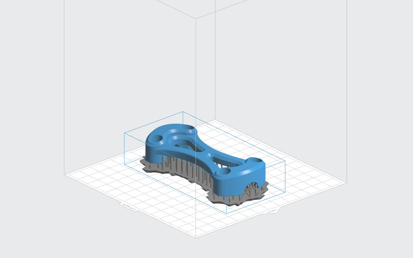

For a successful SLA print, it is critical to reduce the forces on the newly printed layers during the separation stage. The separation stage creates areas of high stress along what is, in some cases, a razor-thin edge that can cause high failure rate and warping if the part sticks to the tank bottom rather than the build plate.
When orienting a part for SLA, the biggest concern should be the z-axis cross-sectional area. The forces that determine if a print sticks to the tank are directly proportional to the print’s 2D cross-sectional area. This is why the part is printed to the plate at an angle, and support reduction is not a primary concern (as shown in the images below). When you are orienting parts for SLA prints, try to minimize the cross-sectional area along the z-axis.
SLA model orientated sub-optimally horizontally with large z-axis cross sectional area.
Model orientated sub-optimally horizontally with large z-axis cross sectional area. In this orientation support is minimised but likelihood of a print failure is high. Print volume = 33.39 mL, print time = 2 hr 27 min
Model re-orientated at an angle reducing z-axis cross sectional area.
Model re-orientated at an angle reducing z-axis cross sectional area. The large increase in support is justified by the reduced likelihood of print failure. Print volume = 36.95 mL, print time = 4 hr 7 min
For designers, it is important to understand how and why part orientation impacts the quality of an SLA print. When you need to orient components so that the z-axis cross-sectional area is reduced, it can result in the model requiring a significant amount of added support. In some instances, a design may need so much support that printing in SLA no longer proves cost-effective. Or the necessary support can be so detrimental to the appearance of the part that, once support has been removed, the result is visually unsatisfactory. To optimize a design for SLA, limit the number of horizontal members, hollow out components and reduce the cross-sectional area.
