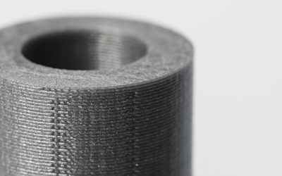

How does part orientation affect accuracy?
To understand how part orientation affects the accuracy of 3D-printed parts, consider the humble cylinder. Let’s say you’re using FDM to print a cylinder with a hole (10 mm outer diameter, 6 mm inner diameter, 30 mm length) with its center axis vertical. The 3D printer will construct this part as a series of concentric circles layered on top of one another, producing a final cylinder with a relatively smooth outer surface.
Suppose the same cylinder is reorientated with its center axis horizontally. The part will be built as a series of rectangles (with slightly different widths) layered on top of each other. Also, the surface of the cylinder that touches the build platform will be flat.
By orientating the part in different directions, there is a significant difference in the print quality.
These two identical cylinders have the same layer height, but were printed with different build orientations (left: vertically, right: horizontally)
