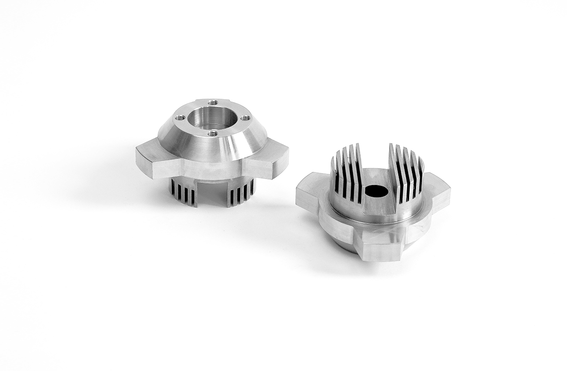

What is aluminum? The robust, economical alloy
cnc-materials-Aluminum-1
A component made of Aluminum 6061
Aluminum alloys have an excellent strength-to-weight ratio, high thermal and electrical conductivity and natural protection against corrosion. They are easy to machine and cost-efficient in bulk, often making them the most economical option for producing prototypes and other types of parts.
While aluminum alloys typically have lower strength and hardness than steels, but they can be anodized, creating a hard, protective layer on their surface.
Let’s break down the different types of aluminum alloys.
  • Aluminum 6061 is the most common, general-use aluminum alloy, with a good strength-to-weight ratio and excellent machinability.
  • Aluminum 6082 has a similar composition and material properties to 6061. It’s more commonly used in Europe (as it complies with British Standards).
  • Aluminum 5083 has higher strength than most other aluminum alloys and exceptional resistance to seawater. This makes it optimal for construction and marine applications. It’s also an excellent choice for welding.
Material characteristics:
  • Typical density of aluminum alloys: 2.65-2.80 g/cm3

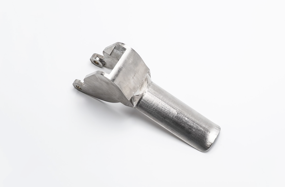

What is stainless steel? The strong, durable alloy
cnc-materials-Stainless steel-4
A part made from Stainless Steel 304
Stainless steel alloys have high strength, high ductility, excellent wear and corrosion resistance and can be easily welded, machined and polished. Depending on their composition, they can be either (essentially) non-magnetic or magnetic.
Let’s break down the types of stainless steel we offer on the platform.
  • Stainless steel 304 is the most common stainless steel alloy. It has excellent mechanical properties and good machinability. It’s resistant to most environmental conditions and corrosive media.
  • Stainless steel 316 is another common stainless steel alloy with similar mechanical properties to 304. It has a higher corrosion and chemical resistance though, especially to saline solutions (for example seawater), so it’s often better for dealing with harsher environments.
  • Stainless steel 2205 Duplex has the highest strength (twice that of common stainless steel alloys) and excellent resistance to corrosion. It’s used in extreme environments, with many applications in Oil & Gas.
  • Stainless steel 303 has excellent toughness, but lower corrosion resistance compared to 304. Due to its excellent machinability, it’s often used in high-volume applications, such as producing nuts and bolts for aerospace.
  • Typical density: 7.7-8.0 g/cm3
  • Non-magnetic stainless steel alloys: 304, 316, 303
  • Magnetic stainless steel alloys: 2205 Duplex, 17-4

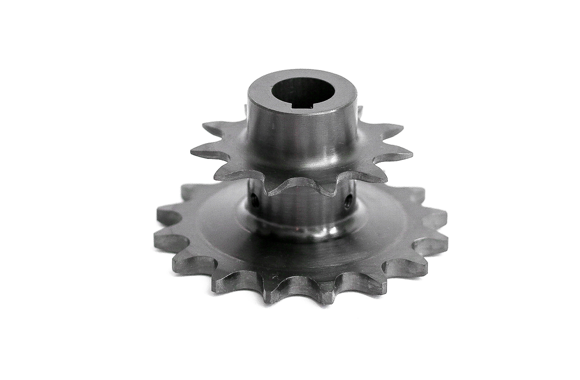

What is mild steel? The general purpose alloy
cnc-materials-Mild steel-2
A part made from Mild Steel 1018
Mild steels are also known as low-carbon steels and have good mechanical properties, great machinability and good weldability. Because they are relatively low cost, manufacturers use them for many general purpose applications, like jigs and fixtures. Mild steels are susceptible to corrosion and chemical damage.
Let’s break down the types of mild steels available on the platform.
  • Mild steel 1018 is a general-use alloy with good machinability and weldability and excellent toughness, strength and hardness. It’s the most commonly used mild steel alloy.
  • Mild steel 1045 is a medium carbon steel with good weldability, good machinability and high strength and impact resistance.
  • Mild steel A36 is a common structural steel with good weldability. It’s suitable for a variety of industrial and construction applications.
  • Typical density: 7.8-7.9 g/cm3
  • Magnetic
