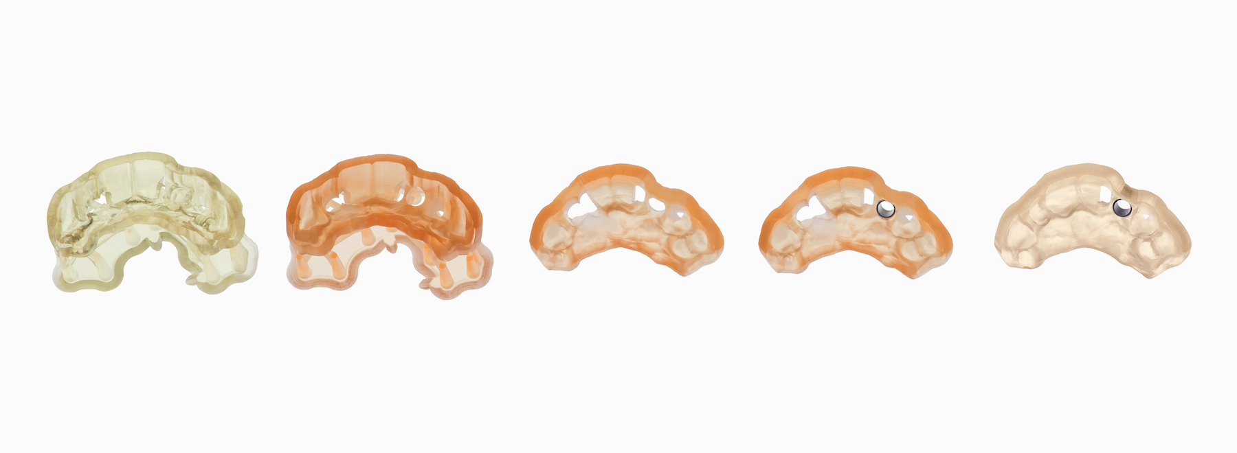

Dental & Medical SLA resins
Custom Medical Appliances Resin (Class I biocompatible)
Class I biocompatible resins can be used to make custom medical equipment, such as surgical guides. Parts printed in this resin can be steam sterilized using an autoclave, for a direct use in the operating room.
Pros:
  • High precision
  • Smooth finish
  • Class I biocompatible (short term use)
Cons:
  • Moderate wear and fracture resistance
Ideal for: surgical aids and appliances
Surgical dental guides printed with SLA in Custom Medical Appliances Resin
Surgical dental guides 3D printed with SLA in Custom Medical Appliances Resin. Image courtesy of Formlabs
Dental Long Term Biocompatible Resin (Class IIa biocompatible)
This resins are specially engineered for long term orthodontic appliances. Class IIa biocompatible resins can be in contact with the human body for up to a year.
Their high resistance to fracture and wear make it perfect to produce custom hard splints or retainers.
Pros:
  • High accuracy
  • High resistance to fracture and wear
  • Class II biocompatibility
Cons:
  • High cost
Ideal for: long term dental appliances, fracture and wear resistant medical parts, hard splints, retainers
Custom dental retainer 3D printed with SLA in Dental Long Term Biocompatible Resin
Custom dental retainer 3D printed with SLA in Dental Long Term Biocompatible Resin. Image courtesy of Formlabs
