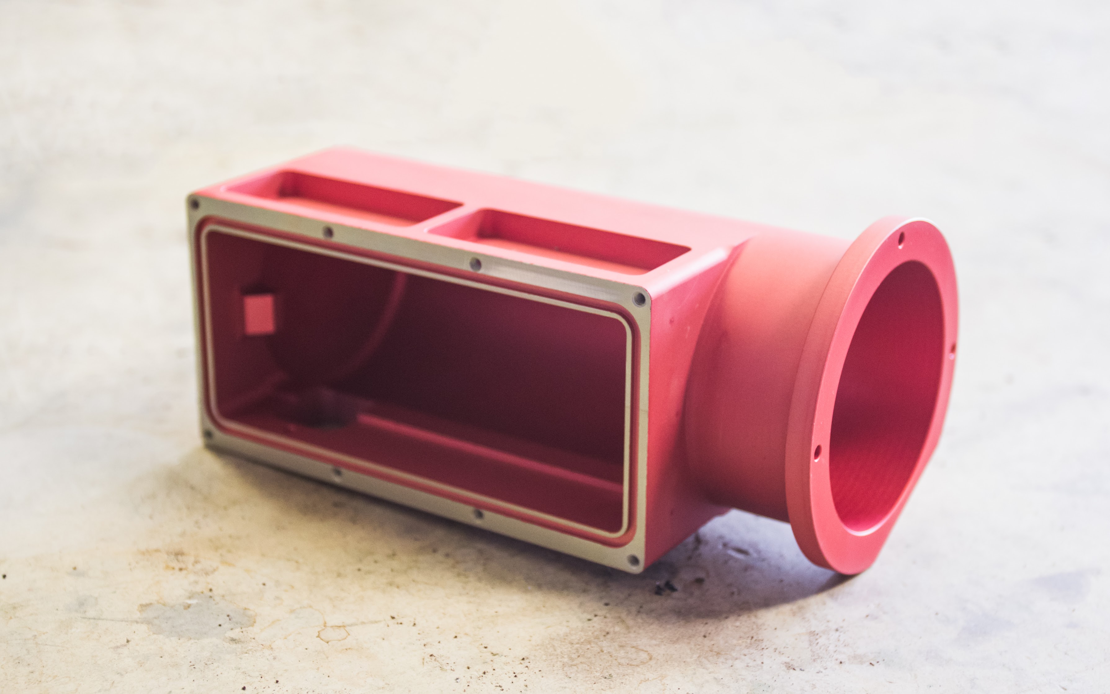

Anodizing (Type II & Type III)
Anodizing adds a thin ceramic layer on the surface of metal parts that protects them from corrosion and wear. The anodic coating is electrically non-conductive, has high hardness and can be dyed to different colors. Anodizing is only compatible with Aluminum and Titanium.
In type II & type III anodizing the part is submerged in a diluted sulfuric acid solution and an electric voltage is applied between the component and the cathode. An electrochemical reaction consumes the material on all exposed surface of the part and converts it into hard aluminum or titanium oxide. A mask can be applied to the surfaces with critical dimensions (like threaded holes) or the surfaces that must remain electrically conductive to prevent them from anodizing.
The anodized parts can also be dyed in various colors before sealing (such as red, blue, black or gold), which gives them an aesthetically pleasing surface finish.
By varying the electric current, anodizing time and consistency and temperature of the solution, coatings of different thickness and density are created:
Anodizing Type II (clear or color)
Anodizing Type II is also called "standard" or "decorative" anodizing and can produce coatings with thickness of up to 25 μm. The typical coating thickness depends on the color and can vary between 8-12 μm for parts dyed black and 4-8 μm for clear (un-dyed) parts.
Type II anodizing is mainly used to produce parts with a smooth, aesthetically pleasing surface and provides good corrosion and limited wear resistance.
Anodizing Type III (hardcoat)
Anodizing Type III is also called "hardcoat" anodizing and can produce coatings up to 125 μm thick. If not otherwise specified, the typical type III anodic coating is 50 μm thick.
Type III anodizing produces thick, ceramic coatings with high density that provide excellent corrosion and wear resistance, suitable for functional applications. It requires though closer process control compared to type II anodizing (higher current density and constant solution temperature near 0oC), so the cost is higher.
Pro-tip:
The anodic coating grows in both directions equally. This means that a 50 μm thick coating will protrude approximately 25 μm above the original surface and that a cylinder with 1 mm diameter before anodizing, will have a diameter of 1.05 mm after anodizing. More details on anodizing can be found in the MIL-A-8625 standard.

Anodized (type II) and dyed red aluminum part. The silver areas were masked during anodizing and chrome plated later
