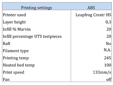

These are the settings that I used for printing the parts.

Great! Did not expect to see these kind of results from a recycled material - its good news. What machine did you print this on? Did you have any issues with sticking at all?
Thanks! I printed it on a Leapfrog Creatr HS. At first I had a lot of trouble getting the filament to stick so I decided to order and install a BuilTak plate. This worked like a charm and I’ve had no issues whatsoever afterwards.
