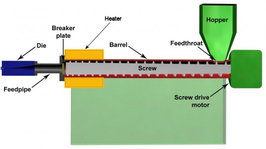

Most extruders work in pretty much the same way. A screw pushes the plastic pieces through a heated area where the plastic is melted. The liquid plastic is then extruded through a nozzle. This is roughly what your average extruder such as the Filabot would look like if you cut it in half:
Check out what this looks like in motion in this short animation. In case your up for a more in depth and seriously '80-ies style explanation check out this video.

1. The heating of the extruder barrel is merely to keep the polymer in a molten state, as well as to homogenise the temperature of the extrudate. The main heat energy is dissipation energy coming from shear forces between the granules in the barrel!
