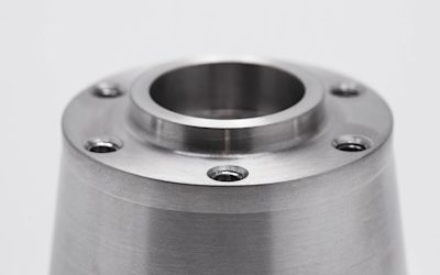

Parts with non-cosmetic finish
Non-cosmetic
Primary machining marks will still be visible
  • As machined
  • Smooth machining
  • Fine machining
  • Chromate Conversion Coating
  • Electroless Nickel Plating
  • Anodized type III (Hardcoat)
  • Powder coating
  • Black oxide

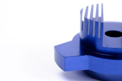

Example of parts with cosmetic surface finish on request
Cosmetic on request
Finishes can be either cosmetic or non-cosmetic as per request
  • Brushed + Anodizing type II
  • Bead Blasted + Anodizing type II
  • Bead Blasted
  • Brushed
