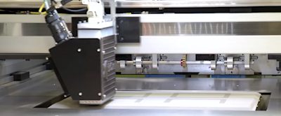

How do Metal 3D printers work?
Similar to all other 3D printing processes, metal 3D printers build parts by adding material a layer at a time based on a digital 3D design - hence the alternative term Additive Manufacturing.
This way, parts can be built with geometries that are impossible to manufacture with "traditional" subtractive (CNC machining) or formative (Metal Casting) technologies, and without the need for specialized tooling (for example, a mold).
Metal 3DP basic steps
From here, the specific steps each metal 3D printer follows to manufacture a part vary greatly by technology:

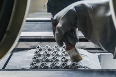

Powder Bed Fusion
A high-power laser (in DMLS/SLM) or an electron beam (in EBM) is used to selectively bond metal powder particles together, layer-by-layer forming the metal part.
Manufacturers: EOS, 3D Systems, Renishaw, SLM Solutions, Concept Laser, Arcam

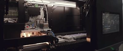

Binder Jetting
Metal powder particles are bound together with an adhesive layer-by-layer, forming a “green” part that needs to be thermally post-processed (sintered) to remove the binder and create a fully-metal part.
Manufacturers: Desktop Metal, ExOne, Digital Metal, HP

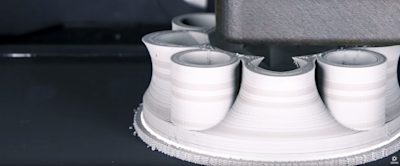

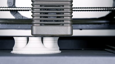

Metal Material Extrusion
A filament or rod consisting of polymer and heavily loaded with metal powder is extruded through a nozzle (like in FDM) to form the “green” part that is post-processed (debinded and sintered) to create a fully-metal part.
Manufacturers: Desktop Metal, Markforged

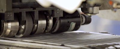

Ultrasonic Additive Manufacturing
Metal foils are bonded layer-by-layer using ultrasonic welding and then formed to the design shape using CNC machining.
Manufacturers: Fabrisonic

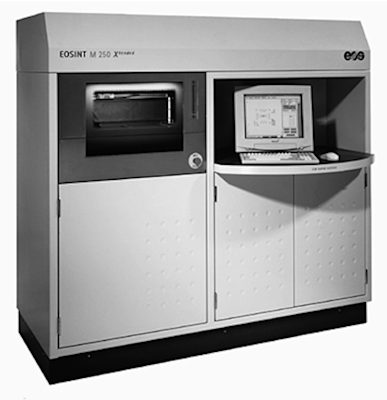

A brief history of Metal 3D Printing
  • In the late ’80s, Dr. Carl Deckard of the University of Texas developed the first laser sintering 3D printer of plastics. This invention paved the way for metal 3D printing.
  • The first patent of laser melting of metals was filed in 1995 by the Fraunhofer Institute in Germany. Companies like EOS and many Universities lead the development of this process.
  • In 1991, Dr. Ely Sachs of MIT introduced a 3D printing process that is today better known as Binder Jetting. Binder Jetting of metal was then licensed to ExOne in 1995.
  • Metal 3D printing saw slow but steady growth in the ’00s. This changed after 2012 when the original patents started expiring and large investments were made by companies like GE, HP and DM.
  • Today, the Wohler’s report estimates metal 3D printing to be a $720 million market and growing rapidly. In 2017 alone, the sales of metal 3D printers increased by 80%.

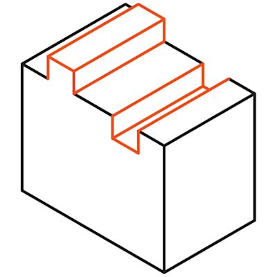

Geometric complexity at no extra cost
The greatest advantage of metal 3D printing compared to "traditional" manufacturing is its exceptional design flexibility. Since no specific tooling is needed (for example, a mold or a cutting tool), geometries that are impossible to manufacture through other processes are easily 3D printable.
More importantly, increasing the geometric complexity of a part has almost no effect on its manufacturing cost. This means that organic, topology optimized structures can be used with metal 3D printing, to greatly improve the performance of the produced parts.
Learn how to design for Metal 3D printing →

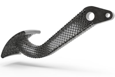

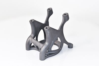

Optimized lightweight structures
The great design flexibility of metal 3D printing goes hand in hand with the creation of lightweight structures. In fact, following best design practices for metal 3D printing always gives a lightweight solution.
Typically, advanced CAD techniques, such as topology optimization and generative design, are usually used for this purpose.
This result in parts with both less weight (typically, by 25% to 50%) and higher stiffness. This is key for high-end applications in industries like the aviation and aerospace.

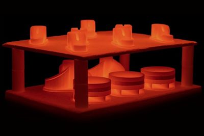

Post-processing is almost always required
Almost every metal 3D printed part will need some post-processing before it is ready to use. This adds to the overall cost and delivery time.
Independent of the selected technology, combinations of thermal treatments, machining, polishing, and other finishing methods are almost always required to produce the final part. We will see more details on the necessary post-processing steps for each technology in later sections.

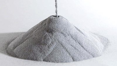

Materials for Metal 3D printing
The number of metal material available for metal 3D printing is growing rapidly. Engineers can today select from alloys including:
  • Stainless steels
  • Tool steels
  • Titanium alloys
  • Aluminum alloys
  • Nickel-based superalloys
  • Cobalt-chrome alloys
  • Copper-based alloys
  • Precious metals (gold, silver, platinum...)
  • Exotic metals (palladium, tantalum...)
For more information on the characteristics and applications for the most common metal 3D printing alloys, follow the links:

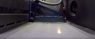

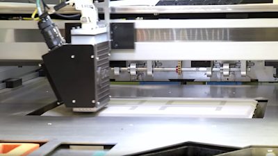

What is DMLS/SLM 3D printing?
A DMLS/SLM metal 3D printer in action
DMLS (Direct Metal Laser Sintering) or SLM (Selective Laser Melting) are two powder bed fusion metal 3D printing technologies. The practical difference between SLM and DMLS are very slim. For design purposes, the two technologies can be treated as the same.
They both use a high power laser to bond metal powder particles together to form a part layer-by-layer. SLM achieves a full melt, while DMLS causes the metal particles to fuse together on a molecular level due to the very high temperatures. Most metal alloys are compatible with the DMLS process, while only certain (pure) metal materials can be used in SLM.

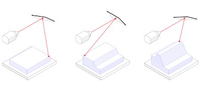

How does DMLS/SLM work?
Schematic of a typical DMLS/SLM 3D printer
Here are the basic steps of the DMLS/SLM 3D printing process:
  • The build chamber is first filled with inert gas and then heated to the optimal print temperature.
  • A thin layer of metal powder (typically 50 μm) is spread over the build platform.
  • The laser scans the cross section of the part, selectively bonding the metal particles.
  • When entire area is scanned, the build platform moves down a layer and the process repeats until the whole build is complete.
  • After printing, the build first needs to cool down and then the loose powder is extracted.
The 3D printing step is only the beginning of the DMLS/SLM manufacturing process. After the print is complete, several (compolsory or optional) post-processing steps are required before the parts are ready to use. Compulsory post-processing steps include:
  • Stress relief: Due to the very high processing temperatures during printing, internal stresses develop. These need to be relieved through a thermal cycle before any other operation.
  • Removal of the parts: In DMLS/SLM the parts are essentially welded onto the build platform. A band saw or EDM wire cutting is used here.
  • Removal of the support: Support in DMLS/SLM is always required to mitigate the warping and distortion that occurs during printing. Support is removed manually or CNC machined.

Metal powders for 3D printing
The raw material used in DMSL/SLM and many other 3D printing processes comes in a powder.
The characteristics of the metal powders are very important for the end results. To ensure good flow and close packing, metal particles need to have a spherical shape and a size between 15 and 45 microns. To achieve these tight requirements, methods such as gas or plasma atomization are commonly used.
The high cost of producing these metal powders is a key contributor to the overall cost of metal 3D printing.
Benefits and limitations of DMLS/SLM
The main strength of DMLS/SLM is its ability to create highly optimized, organic structures from high-performance metal alloys.
Parts manufactured with DMLS/SLM can have a complex, organic shape that is optimized to minimize their weight while maximizing their stiffness. Or they can have internal geometries that cannot be produced with any other method.
The material properties of DMLS/SLM parts are excellent. Parts with almost no internal porosity are manufactured from a wide range of metal alloys, from aluminum and steel to high-strength superalloys.
We saw in a previous section though that the costs connected with DMLS/SLM are high. For this reason, it is only economically viable to use this processes for optimized parts for high-value engineering applications.
From a technical perspective, the main limitation of DMLS and SLM is their need for extensive support structures. These are needed to avoid warping and to anchor the part to the build platform. Also, out of the printer, the surface roughness of the produced parts is relatively high for most engineering applications, so post-processing is necessary.

What is Metal Binder Jetting?
A metal Binder Jetting machine in action
Binder Jetting builds parts by depositing a binding agent onto a thin layer of powder through inkjet nozzles. It was originally used to create full-color prototypes and models out of sandstone. A variation of the process is currently raising in popularity due to its batch production capabilities.
The printing step in metal Binder Jetting printing takes place at room temperature. This means that thermal effects (like warping and internal stresses) are not an issue, like in DMLS/SLM, and supports are not required. An extra post-processing step is necessary to create a fully metal part.
How does Metal Binder Jetting work?
Schematic of a typical Metal Binder Jetting machine
Metal Binder Jetting is a two-stage process. It involves a printing step and an essential post-processing step. Here’s how the printing process works:
  • A carriage with inkjet nozzles passes over the bed, selectively depositing droplets of a binding agent (polymer and wax), bonding the metal powder particles.
  • When a layer is complete, the build platform moves down and the process repeats until the whole build is complete.
The result of the printing process is a part in the so-called “green” state. A post-processing step is required to remove the binding agent and create fully metal parts.
There are two variations for this post-processing step:
  • Infiltration: The “green” part is first washed off from the binding agent to create a “brown” part with significant internal porosity (~70%). The “brown” part is then heated in an industrial oven in the presence of a low-melting-point metal (typically, bronze). The internal voids are filled, resulting in a bi-metallic part.
  • Sintering: The “green” part is placed in an industrial furnace. There, the binder is first burned off and then the remaining metal particles a sintered together. The result is a fully metal part with dimensions that are about 20% smaller than the original “green” part. To compensate for this shrinkage, the parts are printed larger.
Today, sintering is used in the majority of the applications, as infiltration creates parts with inferior material properties and not well documented mechanical and thermal behavior.

What is Metal Extrusion 3D Printing?
A Metal Extrusion 3D printer in action
Metal Extrusion is a variation of the classic FDM process for plastics. The first Metal Extrusion 3D printers were released in 2018. The technology is also known under the names Bound Metal Deposition (BMD) or Atomic Diffusion Additive Manufacturing (ADAM)
Like FDM, a part is built layer-by-layer by extruding material through a nozzle. Unlike FDM, the material is not plastic, but a metal powder held together using a polymer binder. The result of the printing step is a “green” part of that needs to be-debinded and sintered to become fully metal.
How does metal extrusion work?
Schematic of a Metal Extrusion 3D printer
Metal Extrusion is a three-stage process. It involves a printing step, a de-binding step, and a sintering step. Here’s how the printing step works:
  • The raw material comes in a filament or rod form that typically consists of metal particles bound together by polymer and/or wax.
  • This rod or filament is extruded through a heated nozzle and deposited layer-by-layer building a part based on the CAD model.
  • At the same time, support structures are build if necessary. The interface between the support and the part is printed with a ceramic support material, which is easy to manually remove later.

Lattice structures
Applying a lattice pattern is a great way to optimize an existing design.
Lattice structures can create lightweight parts, maximize the surface area of heat exchangers, or improve the printability and reduce the manufacturing cost of an existing design.

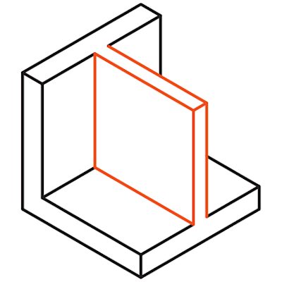

Minimum Wall thickness
DMLS/SLM: 0.4 mm
Binder Jetting: 1.0 mm
Metal Extrusion: 1.0 mm
Binder Jetting & Metal Extrusion parts in the “green” state are fragile. Thicker wall sections reduce the probabillity of breaking.

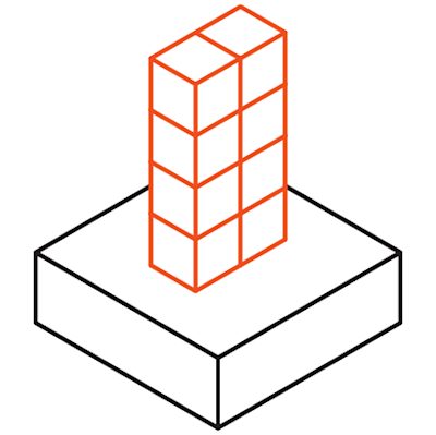

Maximum aspect ratio
DMLS/SLM: 8:1
Binder Jetting: 8:1
Metal Extrusion: 8:1
Extra stability can be added to tall features using support ribs (similar to Injection Molding).

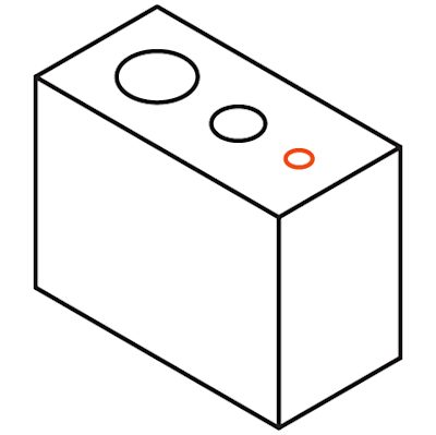

Minimum hole diameter
DMLS/SLM: Ø1.5 mm
Binder Jetting: Ø1.0 mm
Metal Extrusion: Ø1.5 mm
For holes that are not aligned along the build direction, consider using a teardrop shape instead to avoid the need for support.

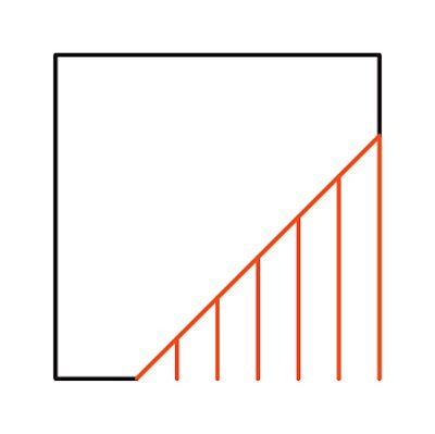

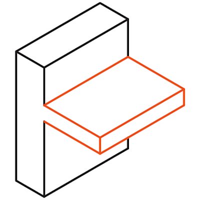

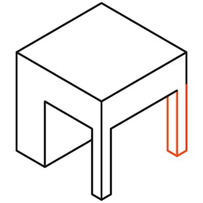

Unsupported edges
DMLS/SLM: 0.5 mm
Binder Jetting: 20 mm
Metal Extrusion: 0.5 mm
Consider eliminating the overhang by adding a 45° chamfer under the unsupported edges.
