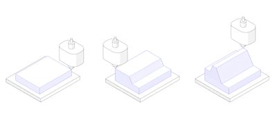

How does 3D printing work?
Every 3D printer builds parts based on the same main principle: a digital model is turned into a physical three-dimensional object by adding material a layer at a time. This where the alternative term Additive Manufacturing comes from.
3D printing is a fundamentally different way of producing parts compared to traditional subtractive (CNC machining) or formative (Injection molding) manufacturing technologies.
In 3D printing, no special tools are required (for example, a cutting tool with certain geometry or a mold). Instead the part is manufactured directly onto the built platform layer-by-layer, which leads to a unique set of benefits and limitations - more on this below.

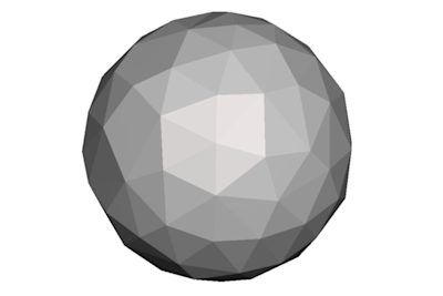

The process always begins with a digital 3D model - the blueprint of the physical object. This model is sliced by the printer's software into thin, 2-dimensional layers and then turned into a set of instructions in machine language (G-code) for the printer to execute.
From here, the way a 3D printer works varies by process. For example, desktop FDM printers melt plastic filaments and lay it down onto the print platform through a nozzle (like a high-precision, computer-controlled glue gun). Large industrial SLS machines use a laser to melt (or sinter) thin layers of metal or plastic powders.

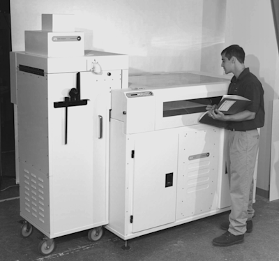

A brief history of 3D printing
- The sci-fi author, Arthur C. Clarke, was the first to describe the basic functions of a 3D printer back in 1964.
- The first 3D printer was released in 1987 by Chuck Hull of 3D Systems and it was using the "stereolithography" (SLA) process.

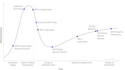

3D printing: beyond the hype
So where is 3D printing today? Is the hype over? Well, maybe but...
The hype of the previous years was based on the idea of widespread consumer adoption. This was (and still is) a misleading interpretation of where the technology actually adds value.
3D printing today has found very specific roles in the world of manufacturing. The inflated expectations of the previous years have given their place to an increased productivity. Many aspects of the technology are now mainstream and adopted by both professional and hobbyists.
Of course, 3D printing is an evolving technology. Every year new 3D printers are released that can have a significant impact on the industry. For example, HP launched their first 3D printing system relatively late (in 2016), but it proved to be one of the most popular industrial 3D printers already by 2017.

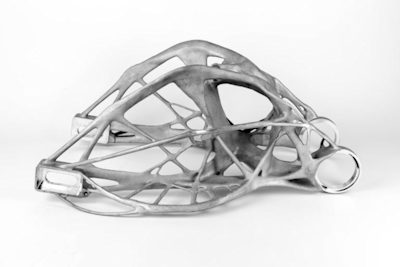

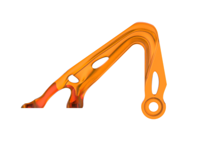

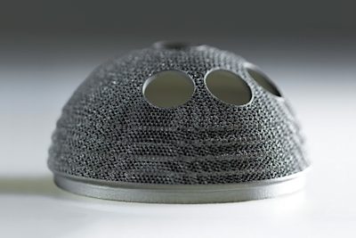

3D printing allows easy fabrication of complex shapes, many of which cannot be produced by any other manufacturing method.
The additive nature of the technology means that geometric complexity does not come at a higher price. Parts with complex or organic geometry optimized for performance cost just as much to 3D print as simpler parts designed for traditional manufacturing (and sometimes even cheaper since less material is used).

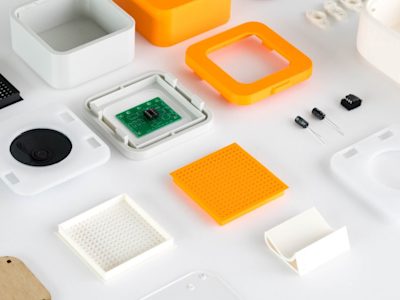

One of the main uses of 3D printing today is prototyping - both for form and function. This is done at a fraction of the cost of other processes and at speeds, that no other manufacturing technology can compete with:
Parts printed on a desktop 3D printer are usually ready overnight and orders placed to a professional service with large industrial machines are ready for delivery in 2-5 days.
The speed of prototyping greatly accelerates the design cycle (design, test, improve, re-design). Products that would require 8+ months tp develop, now can be ready in only 8-10 weeks.

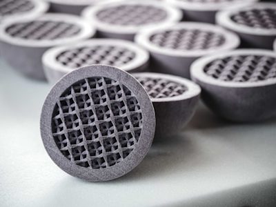

The most common 3D printing materials used today are plastics. Metal 3D printing finds also an increasing number of industrial applications.
The 3D printing pallet also includes speciality materials with properties tailored for specific applications. 3D printed parts today can have high heat resistance, high strength or stiffness and even be biocompatible.
Composites are also common in 3D printing. The materials can be filled with metal, ceramic, wood or carbon particles, or reinforced with carbon fibers. This results in parts with unique properties suitable for specific applications.

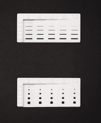

The accuracy of 3D printed parts depends on the process and the calibration of the machine. Typically, parts printed on a desktop FDM 3D printer have the lowest accuracy and will print with tolerances of ± 0.5 mm. This means that if you design a hole with diameter of 10 mm, its true diameter after printing will something between 9.5 mm to 10.5 mm.
Other 3D printing processes offer greater accuracy. Industrial Material Jetting and SLA printers, for example, are able to produce parts down to ± 0.01 mm. It is important to keep in mind though, that these results can only be achieved after optimisation for specific features in a well-designed part.

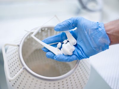

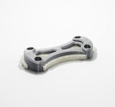

Printed parts are rarely ready to use off the printer. They usually require one or more post-processing steps.
For example, support removal is needed in most 3D printing processes. 3D printers cannot add material on thin air, so supports are structures that are printed with the part to add material under an overhang or to anchor the printed part on the build platform.
When removed and they often leave marks or blemishes on the surface of the part they came in contact with. These areas need additional operations (sanding, smoothing, painting) to achieve a high quallity surface finish.

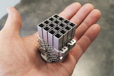

Aerospace and Space engineers use 3D printing to manufacture high-performance parts. The ability to create topology optimized structures with high strength-to-weight ratio and the possibility to consolidate multiple components into a single part are particularly appealing.
Optisys LLC is a provider of micro-antenna products for aerospace and defense applications. They used metal 3D printing to reduce the number of discrete pieces of their tracking antenna arrays from 100 to only 1. With this simplification, Optisys managed to reduce the lead time from 11 to 2 months, while achieving a 95% weight reduction.

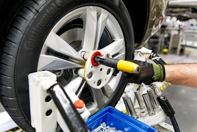

Automotive
The automotive industry has benefited greatly from the fast turnaround and the ease of customization offered by 3D printing.
Volkswagen traditionally used CNC machining to create custom jigs and fixtures. CNC has typically longer production times and higher cost. The same jigs and fixtures could be 3D printed overnight and tested on the assembly line the next day. Feedback from the operators was incorporated almost immediately and a new jig was ready to test the next day until the perfect tool was created.

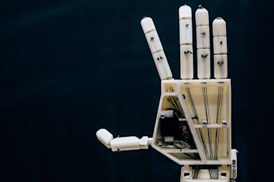

Robotics
In the field of robotics & automation, custom one-off parts are very often needed to develop new robotic mechanisms. 3D printing has evolved into one of the main manufacturing technologies of this industry, because of its speed, great design freedom and ease of customization. The large range of material options with unique properties, also allows the creation of unique structures, such as "soft" robots.
A team of engineering students from the University of Antwerp built a humanoid robotic arm that can translate speech into sign language and they used 3D printing almost exclusively to manufacture all custom structural parts of their robot.

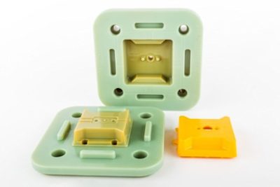

Industrial tooling
The development of new 3D printing materials with high heat resistance and stiffness, combined with the ability to create custom parts quickly and at a low cost, pushed 3D printing to find multiple applications around industrial tooling.
For example, 3D printing is used today to manufacture low-run injection molds. These molds are used to produce a few hundred parts (compared to the 10.000+ of metal molds), but come at a fraction of the cost of a "traditional" mold and can be manufactured overnight. This makes them ideal for low-volume, low-cost production or small tests runs before full scale manufacturing.

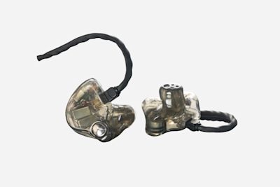

Did you know that today in the US hearing aids are manufactured almost exclusively using 3D printing? In fact, the companies that did not adopt the technology, very fast when out of business, as they could not keep up with the competition.
The healthcare and prosthetics field has benefited greatly by adopting 3D printing. Custom shapes, such as hearing aids, no longer need to be made through manual labor. With 3D printing, they can be manufactured quickly from a digital file (by 3D scanning the patient's body, for instance). This brings substantially lower costs and lower production times.

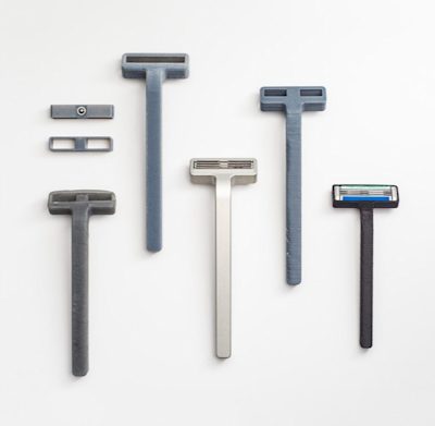

Product design

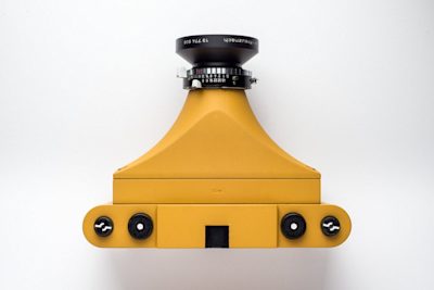

With the help of 3D printing, product designers can easily customize their products at no extra costs. They can also create high-quality functional prototypes for a new product concept. This accelerates the design cycle and proves that their product idea works before a larger investment is made.
For example, Paul Kohlhaussen designed and created a functional prototype of his ultimate camera. He combined camera parts from different models and merged them together with a custom 3D printed body. He then took his idea to Kickstarter to succesfuly get funding for his project.

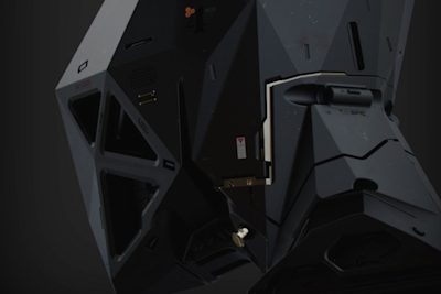

Entertainment
3D printing is one of the favorite tools of movie makers today, due its ability to create believable props. The high design flexibillity of 3D printing helps entertainment professionals bring to life objects of their imagination. This can now be done quickly and at a much lower cost than the past.
One example comes from Vitaly Bulgarov, a concept designer whose resume includes working with movie studios. like Paramount and Dreamworks. He used 3D printing to quickly turn his computer sketches into a usable physical objects for a film he was working on.

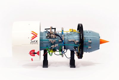

Aerospace engineering students from the University of Glasgow worked together with Rolls Royce to create a functional 3D printed jet engine model. The model gives instant feedback to the students about changes they make during it operation, helping them gain very valuable practical experience.

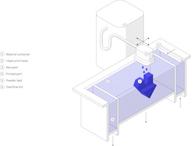

- Binder Jetting (BJ): Liquid bonding agent selectively binds regions of a powder bed

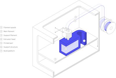

Fused Deposition Modelling (FDM)
In FDM, a spool of filament is loaded into the printer and then fed to the extrusion head, which is equipped with a heated nozzle. Once the nozzle reaches the desired temperature, a motor drives the filament through it, melting it.
The printer moves the extrusion head, laying down melted material at precise locations, where it cools and solidifies (like a very precise hot-glue gun). When a layer is finished, the build platform moves down and the process repeats until the part is complete.
After printing, the part is usually ready to use but it might require some post-processing, such as removal of the support strucures or surface smoothing.
FDM is the most cost-effective way of producing custom thermoplastic parts and prototypes. It also has the shortest lead times - as fast as next-day-delivery - due to the high availability of the technology. A wide range of thermoplastic materials is available for FDM, suitable for both prototyping and some functional applications.
As of limitations, FDM has the lowest dimensional accuracy and resolution compared to the other 3D printing technologies. FDM parts are likely to have visible layer lines, so post-processing is often required for a smooth surface finish. Additionally, the layer adhesion mechanism makes FDM parts inherently anisotropic. This means that they will be weaker in one direction and are generally unsuitable for critical applications.

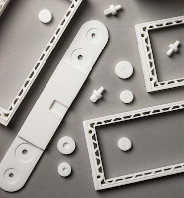

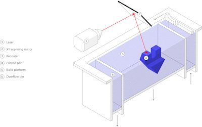

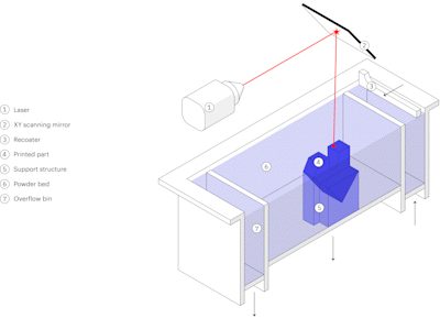

Selective Laser Sintering (SLS)
The SLS process begins with heating up a bin of polymer powder to a temperature just below the melting point of the material. A recoating blade or roller then deposits a very thin layer of powder - typically 0.1 mm thick - onto the build platform.
A CO2 laser scans the surface of the powder bed and selectively sinters the particles, binding them together. When the entire cross-section is scanned, the building platform moves down one layer and the process repeats. The result is a bin filled with parts surrounded by unsintered powder.
After printing, the bin needs to cool before the parts are removed from the unsintered powder and cleaned. Some post-processing steps can then be employed to improve their visual appearance, such as polishing or dying.
SLS parts have very good, almost-isotropic mechanical properties, so they are ideal for functional parts and prototypes. Since no support structures are required (the unsintered powder acts as support), designs with very complex geometries can be easily manufactured. SLS is also excellent for small-to-medium batch production (up to 100 parts), since the bin can be filled throughout its volume and multiple parts can be printed at a single production run.
SLS printers are usually high-end industrial systems. This limits the availability of the technology and increases its cost and turn-around times (compared to FDM or SLA, for example). SLS parts have a naturally grainy surface and some internal porosity. If a smooth surface or watertightness is required, additional post-processing steps are needed. Beware that large flat surfaces and small holes need special attention, as they are susceptible to thermal warping and oversintering.

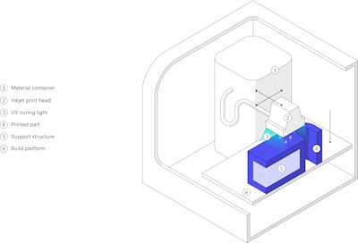

Material Jetting (PolyJet)
Material Jetting works in a similar way to standard inkjet printing. However, instead of printing a single layer of ink on a piece of paper, multiple layers of material are deposited upon each other to create a solid part.
Multiple print heads jet hundreds of tiny droplets of photopolymer onto the build platform, which are then solidified (cured) by the UV light source. After a layer is complete, the build platform moves down one layer and the process repeats.
Support structures are always required in Material Jetting. A water-soluble material is used as support that can be easily dissolved during post-processing and that is printed at the same time as the structural material.
Material Jetting is the most precise 3D printing technology (with SLA/DLP being a close second). It is one of the few 3D printing processes that offers multi-material and full-color printing capabilities. Material Jetted parts have a very smooth surface - comparable to injection molding - and very high dimensional accuracy, making them ideal for realistic prototypes and parts that need an excellent visual appearance.
Material Jetting is one of the most expensive 3D printing processes and this high cost may make it financially unviable for some applications. Moreover, parts produced with Material Jetting are not best suited for functional applications. Like SLA/DLP, the materials used with this process are thermosets, so the produced parts tend to be brittle. They are also photosensitive and their properties will degrade over time with exposure to sunlight.

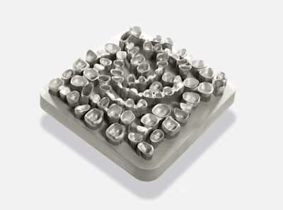

Direct Metal Laser Sintering & Selective Laser Melting (DMLS & SLM)
Direct Metal Laser Sintering (DMLS) and Selective Laser Melting (SLM) produce parts in a similar way to SLS: a laser source selectively bonds together powder particles layer-by-layer. The main difference, of course, is that DMLS and SLM produce parts out of metal.
The difference between the DMLS and SLM processes is subtle: SLM achieves a full melt of the powder particles, while DMLS heats the metal particles to a point that they fuse together on a molecular level instead.
Support structures are always required in DMLS and SLM to minimize the distortion caused by the high temperatures required to fuse the metal particles. After printing, the metal supports need to be removed either manually or through CNC machining. Machining can also be employed to improve the accuracy of critical features (e.g. holes). Finally, the parts are thermally treated to eliminate any residual stresses.
DMLS/SLM is ideal for manufacturing metal parts with complex geometries that traditional manufacturing methods cannot produce. DMLS/SLM parts can be (and should be) topology optimized to maximize their performance while minimizing their weight and amount of material used. DMLS/SLM parts have excellent physical properties, often surpassing the strength of the rough metal. Many metal alloys that are difficult to process with other technologies, such as metal superalloys, are available in DMLS/SLM.
The costs associated with DMLS/SLM 3D printing are high: parts produced with this processes typically cost between $5.000 and $25.000. For this reason, DMLS/SLM should only be used to manufacture parts that cannot be produced with any other method. Moreover, the build size of modern metal 3D printing systems is limited, as the required precise manufacturing conditions are difficult to maintain for bigger build volumes.

Binder Jetting
Binder Jetting is a flexible technology with diverse applications, ranging from low-cost metal 3D printing, to full-color prototyping and large sand casting mold production.
In Binder Jetting, a thin layer of powder particles (metal, acrylic or sandstone) is first deposited onto the build platform. Then droplets of adhesive are ejected by a inkjet printhead to selectively bind the powder particles together and build a part layer-by-layer.
After the print is complete, the part is removed from the powder and cleaned. At this stage it is very brittle and additional post-processing is required. For metal parts this involves thermal sintering (similar to Metal Injection Molding) or infiltration with a low melting-point metal (for example, bronze), while full-color parts are infiltrated with cyanoacrylate adhesive.
Binder Jetting can produce metal parts and full-color prototypes at a fraction of the cost of DMLS/SLM or Material Jetting respectively. Very large sandstone parts can also be manufactured with Binder Jetting, as the process is not limited by thermal effects (for example, warping). Since no support structures are needed during printing, metal Binder Jetting parts can have very complex geometries and, like SLS, low-to-medium batch production is possible by filling up the whole build volume.
Metal Binder Jetting parts have lower mechanical properties than the bulk material though, due to their porosity. Due to the special post-processing requirements of Binder Jetting, special design restrictions apply. Very small details, for example, cannot be printed, as the parts are very brittle out of the printer and may break. Metal parts might also deform during the sintering or infiltration step if not supported properly.

The STL file format
STL is the industry standard file format that all 3D printers use. They use triangles to represent the outer and inner surfaces of a solid 3D object.
Think of STLs files as the PDFs of 3D printing: they contain all the information needed to print a model, but they are not easy to edit.

Here are the top 3 things to look out for:
- Overhangs & support: 3D printers cannot deposit material on thin air. Walls at an angle greater than 45° will require support, affecting the surface quality.
- Level of detail: The smallest feature a printer can create depends on the size of the end effector (nozzle or laser) it uses.
- Layer height: The layer height affects the vertical resolution of a part. It's effects are visible are areas with greater curvature (it appears as stair-stepping).
