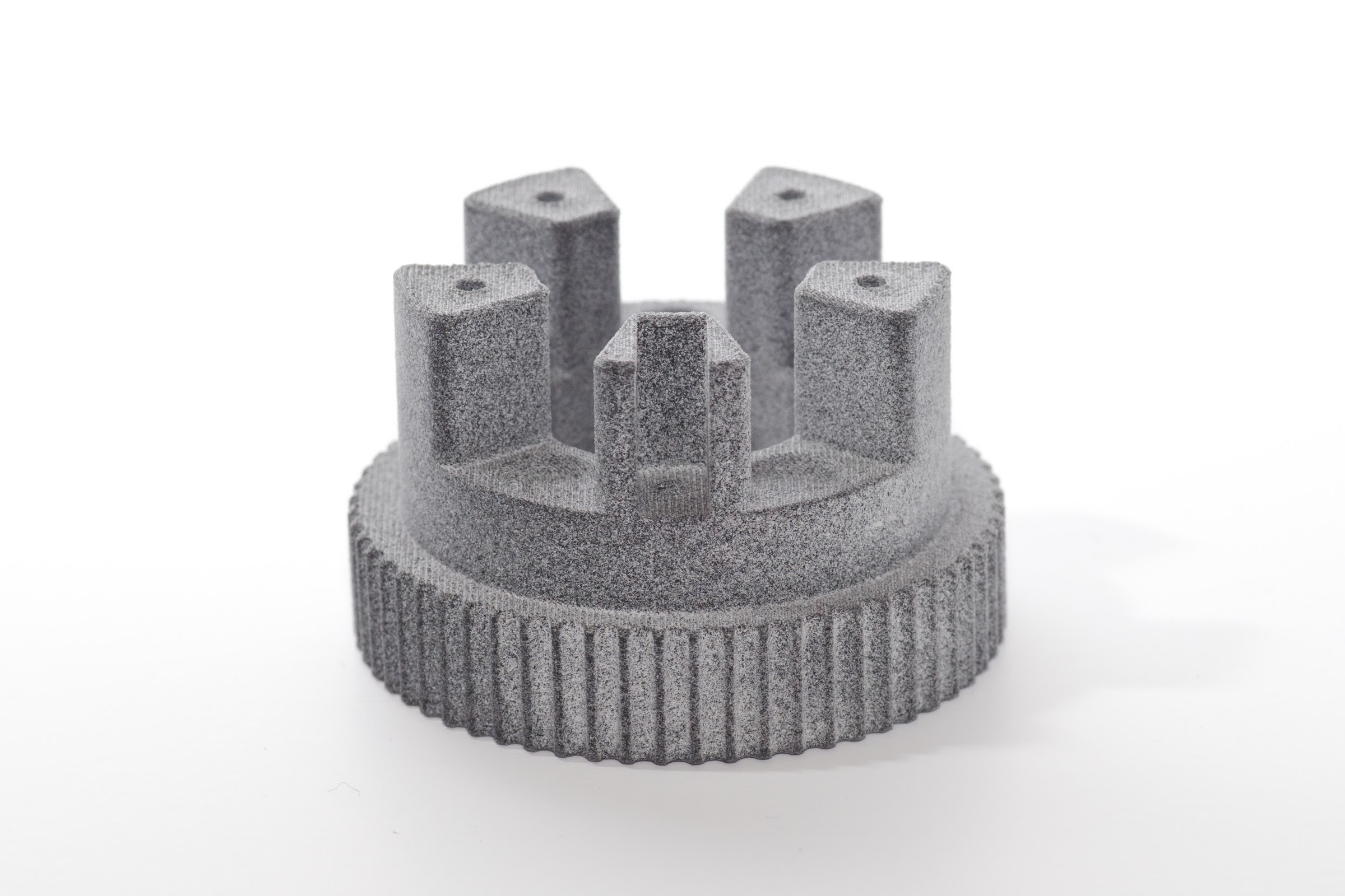

Multi Jet Fusion
To print using MJF, the machine first spreads a thin layer of powder over the build platform. The printer heats this layer to a near-sintering temperature. A carriage with inkjet nozzles (which are similar to the nozzles used in desktop 2D printers) passes over the bed, depositing a fusing agent on the powder. At the same time, the machine prints a detailing agent that inhibits sintering near the edge of the part.
A powerful IR energy source then passes over the build bed and sinters the areas where the fusing agent was deposited, leaving the rest of the powder unaltered. The process repeats until all parts are complete.
Similar to SLS, the printed parts are embedded in powder and need to cool down before they can be removed for further processing. For more detail on MJF, read our breakdown of the technology in What is Multi Jet Fusion (MJF)? Explained by Protolabs Network.
3DP 101 - MJF nylon part
An MJF part, printed in nylon

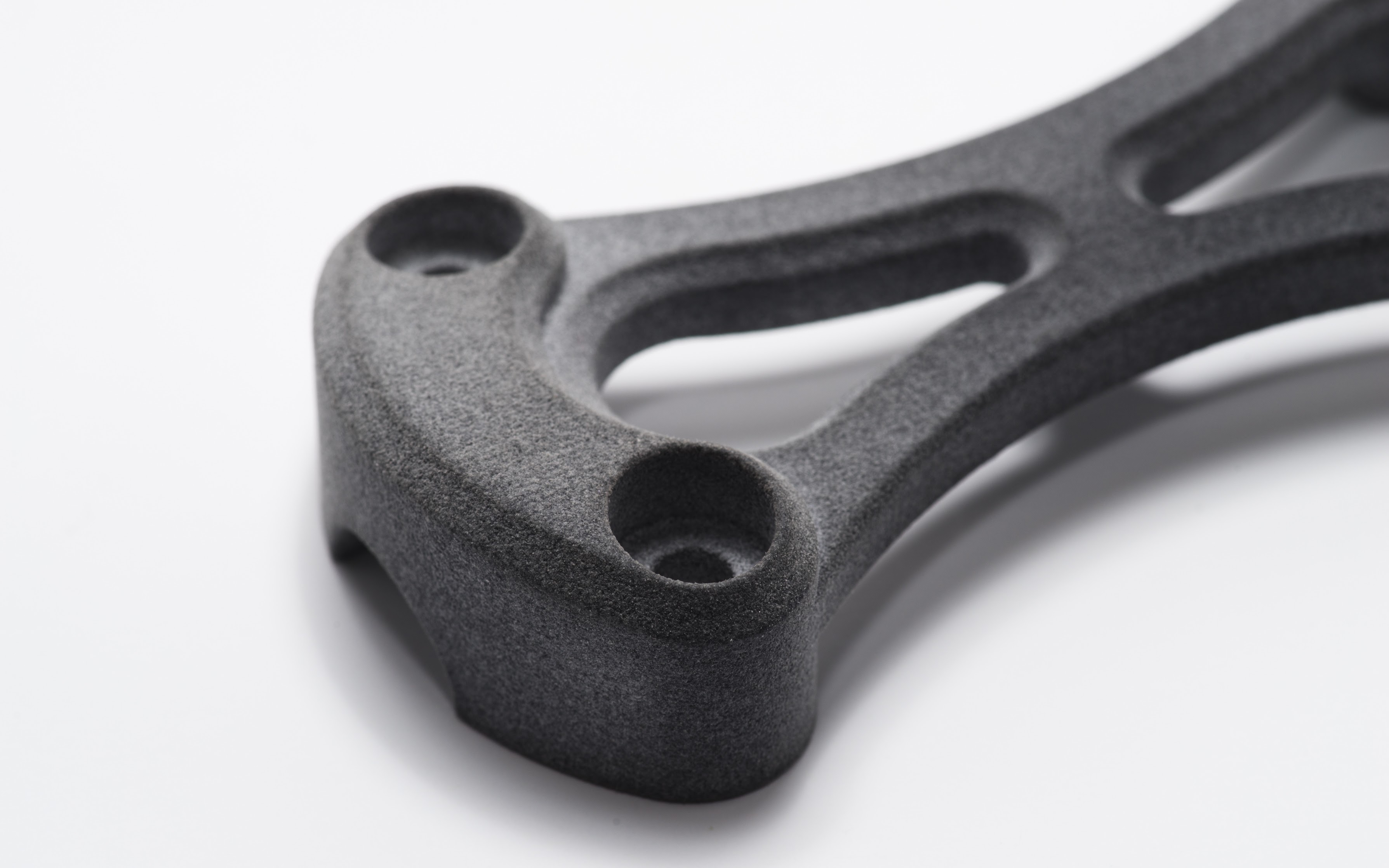

3D printing parts with either SLS and MJF technology leads to grainy surface finishes that can be post-processed to a high standard. If one of your main requirements for your part is aesthetic appeal, we recommend dying as part of your post-processing.
In terms of color, MJF systems presently use a black fusing agent, as dark materials absorb radiation more effectively. As a result, parts printed with MJF have a light gray appearance. You can opt for an additional dying step to achieve a uniform black finish.

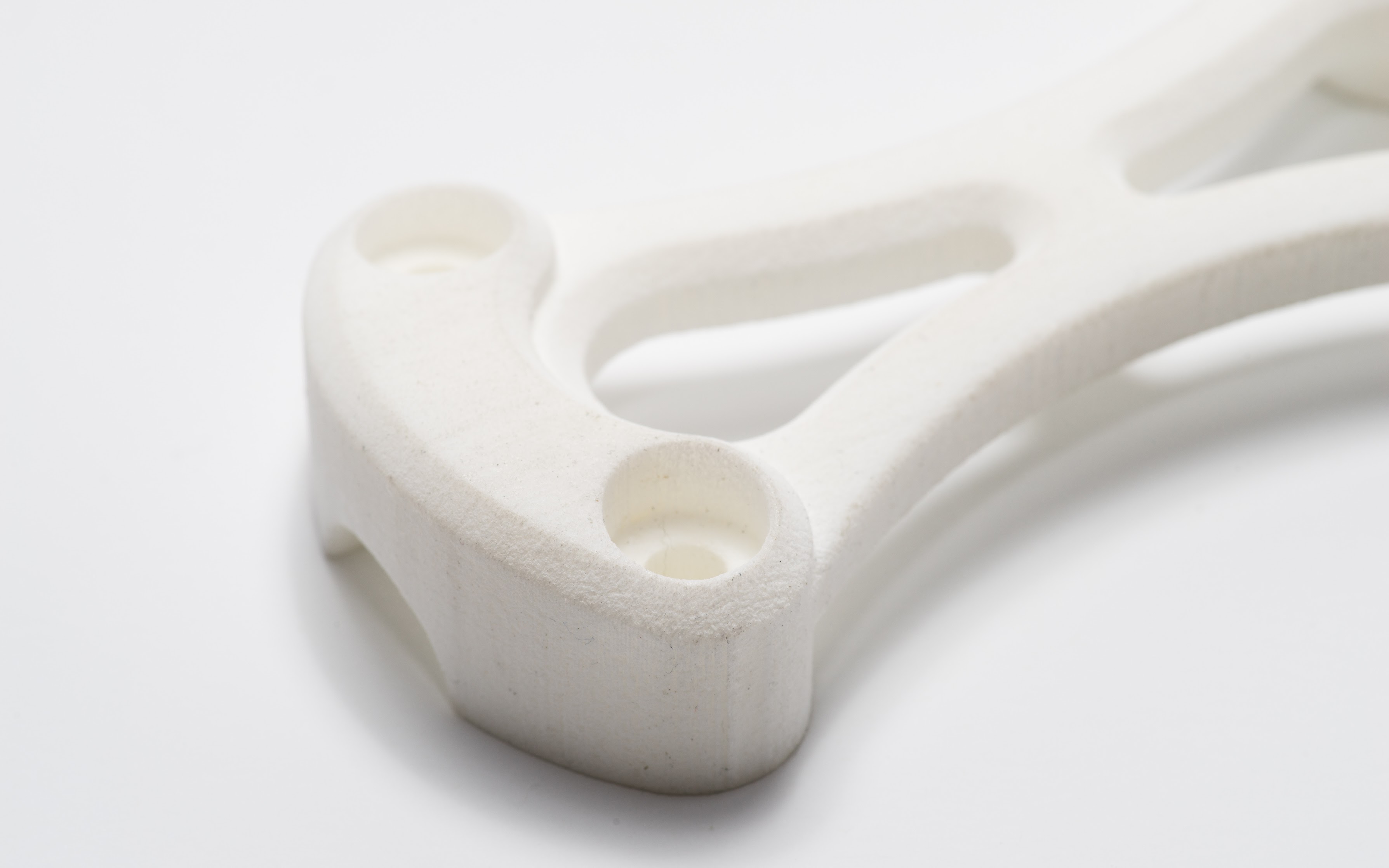

SLS parts, on the other hand, are usually printed white and can be dyed to any color. Grey SLS nylon powder is also available, and parts printed in this material will look similar to MJF parts but smoother to the touch.
4-MJF-grey
An MJF part, as printed
4-MJF-black
An MJF part, after dyeing black

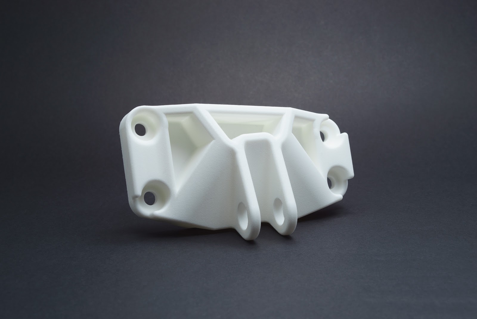

SLS is an excellent choice when strong, functional parts such as brackets are required. This part is printed with white SLS nylon.
An SLS part, printed in white nylon
