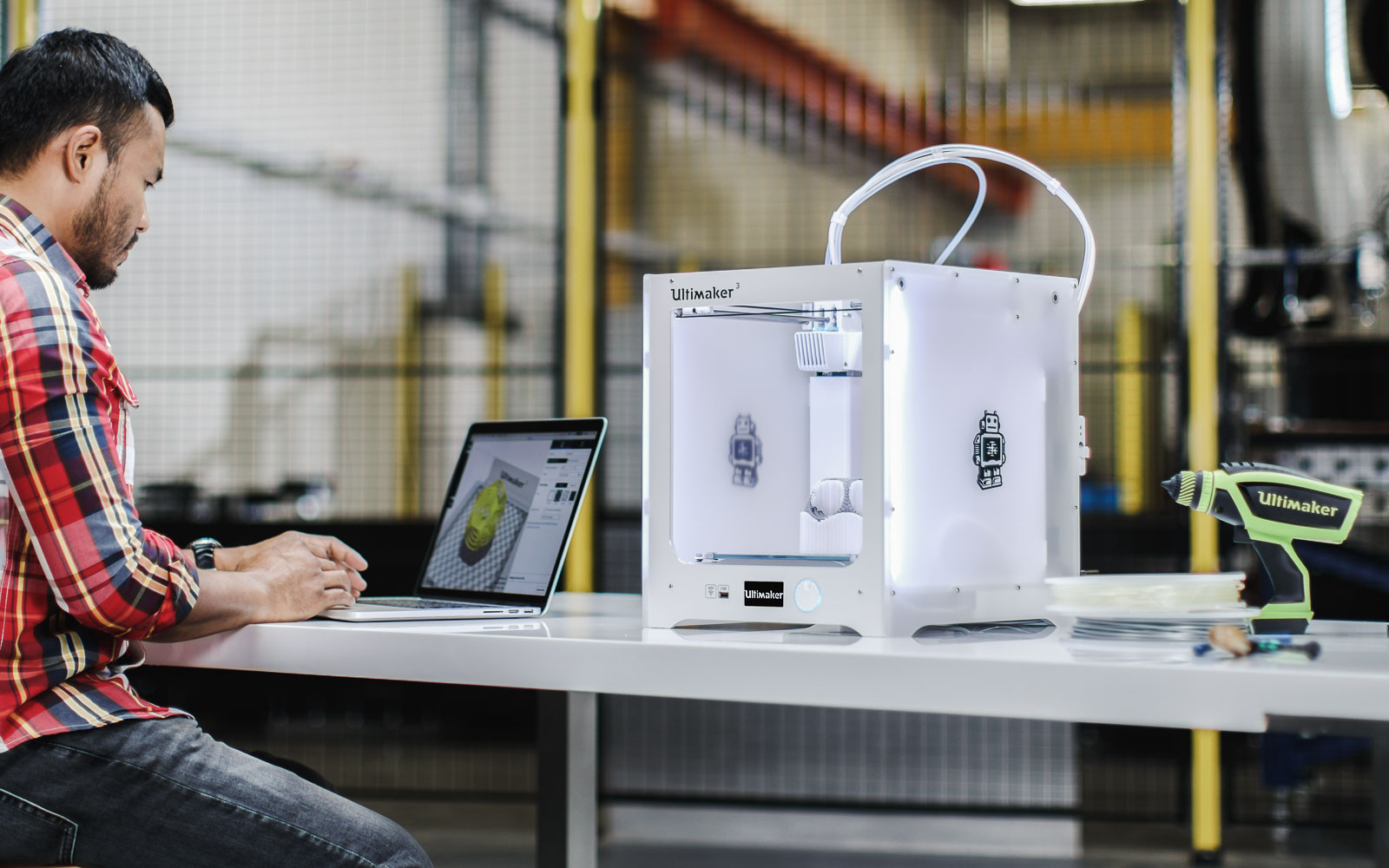

On the other hand, desktop FDM 3D printers are now catching up and there are machines that support these advanced features (i.e. calibration algorithms, heated chamber, higher printing temperatures and dual extrusion). A well calibrated basic desktop FDM machine can produce parts with fairly high dimensional accuracy (typically with tolerances of ± 0.5 mm) and with the same minimum feature size as industrial FDM machines (i.e. approx. 1 mm). This accuracy is sufficient for most applications. Most materials used in desktop FDM printing allow for critical dimensions (e.g. holes) or detailed features (e.g. threads) to be machined accurately in a post processing step.
Desktop FDM are perfect for fast, user friendly, cost effective prototyping (image courtesy of Ulitmaker)
