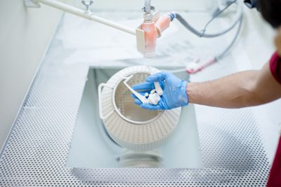

This is the default finish for SLS. Parts are removed from the build chamber and all powder is removed from the part with compressed air. The surface is then also cleaned via plastic bead blasting to remove any un-sintered powder sticking to the surface. This finish is inherently rough, similar to a medium grit sandpaper (satin-like matte finish that is slightly grainy). This is also the best surface preparation for painting or lacquering.

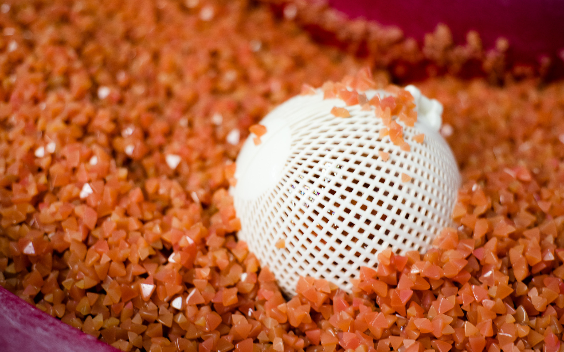

For a smoother surface texture, Nylon SLS parts can be polished in media tumblers or vibro machines. A tumbler that contains small ceramic chips that vibrate against the object gradually erode the outer surface down to a polished finish. As a result, this process does have a small effect on part dimensions and results in rounding sharp edges. It is not recommended that parts with fine details and intricate features are tumbled.

SLS parts being tumble/vibro polished
