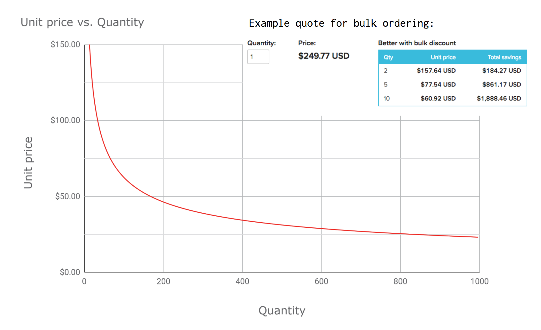

Taking advantage of Economies of Scale (Extra Tip)
In CNC machining, the quantity greatly affects the unit price. This is because the startup costs are relatively high and, when quantities are low, they represent a big percentage of the cost. For large quantities though, they get almost eliminated as these costs are spread over many parts.
In the graph below, we summarized the average unit price of 12 different parts machined in Stainless Steel 304.
Unit price vs Quantity in CNC machining
The drop in unit price is almost exponential: even a small increase in quantity can decrease the unit price by a lot. Notice that ordering very high volumes (> 100 parts) reduces the unit price by 5 to 10 times. The effect of economies of scale are noticeable also for low volumes.
Actually:
Increasing the quantity from 1 to 5 can decrease the unit price by more than 50%!
To minimize cost:
  • Take advantage of economies of scale by ordering higher quantities or placing a repeat order.
