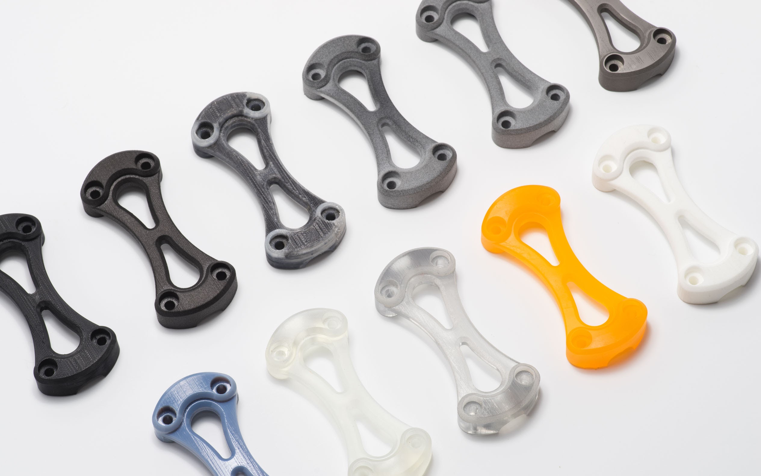

3DP 101 - brackets 01
A test bracket printed in range of different 3D printed materials
