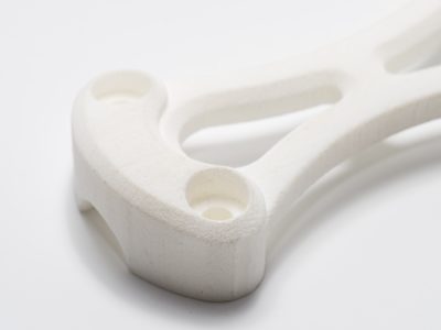

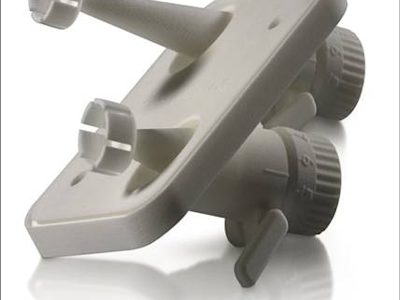

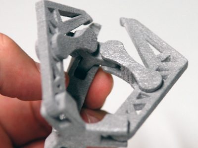

SLS nylon as-printed white As printed As printed SLS parts are typically white or stone grey in color with a smooth surface and a powder texture and without visible layers.

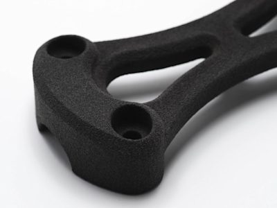

SLS nylon dyed black Dyed SLS parts can be dyed by immersing in a warm color bath to a variety of colors. The color penetration reaches an approximate depth of 0.5 mm and covers all surfaces.
